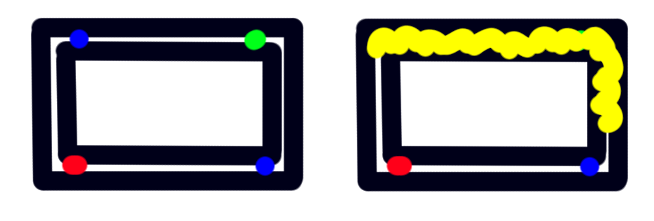

Any metal part that is brown and has holes does not contribute to structural soundness so have to be flexed out. But wait with that for welding confidence for places MOT will see.
For welding watching youtube should help. A welder chooses the best way flexing parts out to be able to make straight lines. All metal that is not original thickness is not suitable for welding.
One does not put a slightly larger plate over a hole. The plate has to fit nicely. The heat generated by the welder will deform your just made plate. To overcome this you do the following
Flex out the rust preferably in square or something close like trapezium etc. Flex a nicely fitting plate about touching the spot to weld. Don't look at the image for this. It has to be snug. Then start welding a small weld on red, then on green, then on blue. There a two blue dots, it doesn't matter but now you go welding the heat will be spread nicely.
Then the yellow, this are halve moons, you weld in halve moons. For MOT overhere you can skip half welding but it is easier to keep on going with halve moons.
I hope this is clear, I am not an experienced welder but if you don't do it like this is will be pittiful.
Also, you will need to be aware that carpets and plastics are going it to melt, then it will burn (it can pick up fire several inches away). Theoretically your car might catch fire and will show 5 minutes after your last weld. A fire extinguisher is nice to have. This kind of fire can damage your car beyond reasonable repair and the dashboard is the most sensitive place, if your dash melts with your loom you loose the car.
Keep in mind you will have to look at youtube bit since I couldn't find anything on moon welding, heat transfer and why plates have to be snug, I drew it up for you. It is how professionals weld their stuff.
Also keep in mind if you have a 3 dimensional hole you weld it up 2 dimensional so part of the first plate should be welded with the second plate. The deforming of plates will be notably, no need to create a 3 dimensoinal plate, it won't fit half way.
I hope this helps and please surf the web or even better get some experienced person with the car and ask him about moon welding and heat transfer, I am not a professional welder.

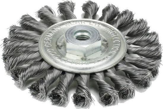

One important last thing, the plate you weld in does not have to be new but anything not metal needs to be sanded off. Welders won't weld trough paint. You need clean welds, or it will rust just as hard. To prevent sanding rust and make metal thinner I recommend a rotary thingy shown below,
It will prevent to make the metal thinner and still nicely remove paint or rust. The new or used plate you weld in must be exact the same thickness to prevent heat transfer issues.

Thank you for the reply Richard.
That is a great amount of information. And the diagrams are perfect.
I have started watching a few YouTube videos.
I need to just having a go now.
I have an old car bonnet that I'm going to cut up and practise welding on first.
I will get some more pictures soon.
Thanks again
